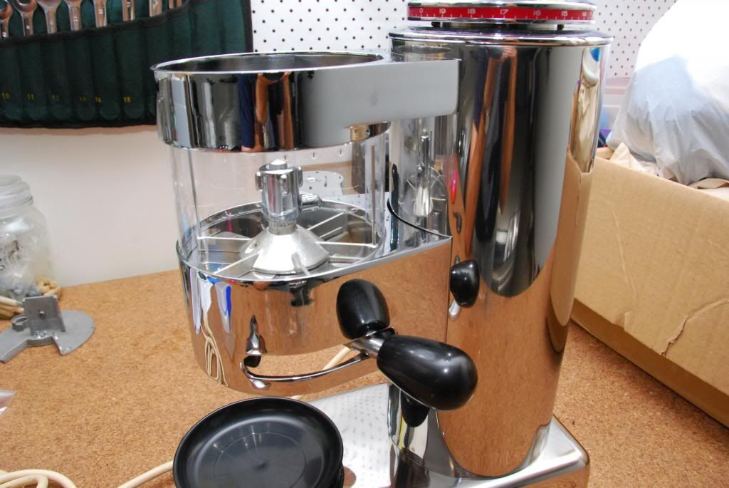

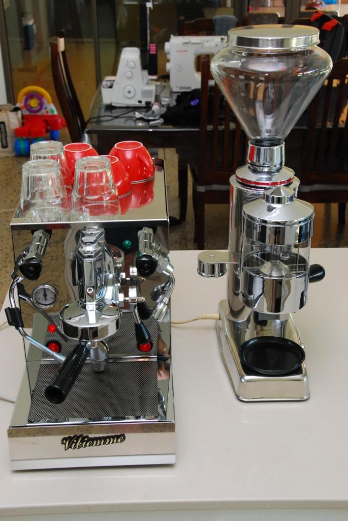

    Ok so I finally got an hour or so to put it through its paces. I have only put about 200grams through it trying to dial it in. I've managed to get it pretty close - just trying to work out a technique as this is my first doser grinder and I haven't yet got the portafilter holder made up.
    It certainly looks shiny next to the Vibiemme and the doser mechanism seems smooth and sweeps fairly clean I think.
    I certainly got some very nice looking pours - tonnes of crema, from only day old beans and tried it as espresso (which I don't normally drink but am trying to broaden my palate). The grinds seemed very fluffy.
    I've got it on the kitchen bench and will play with it more over the coming weeks when my work load reduces a bit from what it is now.
    Of course, I have more photos....
    This last one is a bit of an action shot. I thought there is way too much shiny stuff not being used the way its supposed to so this one's during the first time frenzy..

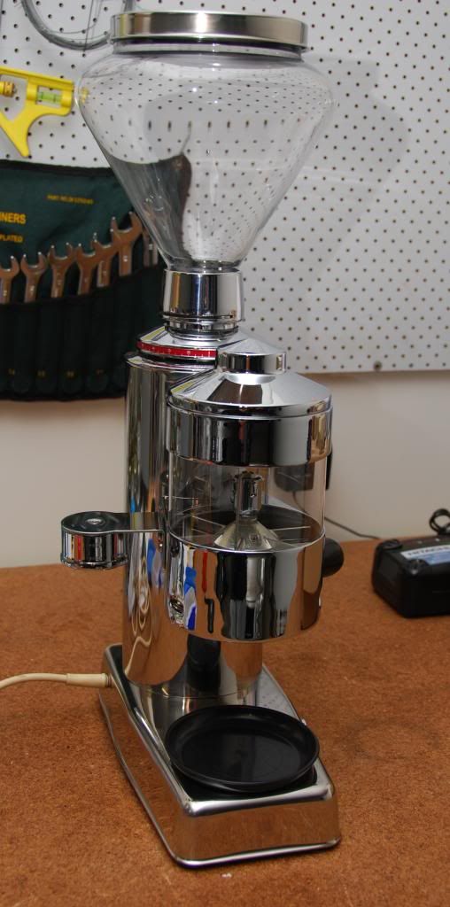

    Another update on the progress...
    It has been a little slow of late, the bottom of the doser had to go back to the chrome shop for another try as there was an 'airlock', which left an unsightly nickel spot. All good now though.
    The doser lens has been cut, shaped and glued and has turned out a very good fit - I just need to tidy up the glue spots at the join a bit to make it more presentable.
    I've ordered the portafilter holder from a laser cutting shop. I have the grinds tray which is an acceptable solution but I'm not entirely happy with it as is because it can move around a bit too much.
    I guess its now time to fire it up and see what its' like. I probably do so in the next couple of days when I get time. Here are some photos of the shiny almost finished product...

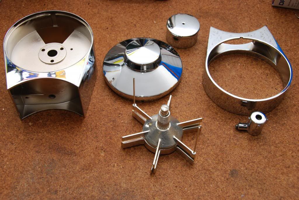

    Ok, I got the parts back from the chromers - on the whole, really impressed! The outer sections were chromed and where the grinds come into contact with the doser chamber and sweepers it has been tinned for food safety reasons.
    Items still to tackle are the doser lens which I was waiting until these parts returned so that I could cut the polycarbonate lens to size and also the portafilter holder. I've been having trouble finding someone to fabricate the portafilter holder. The only quote I've had so far is $125 + GST which does make it quite prohibitive unfortunately. I've put a WTB in the for sale section to see if someone has one lying around they no longer need - this is quite a long shot but, you never know.

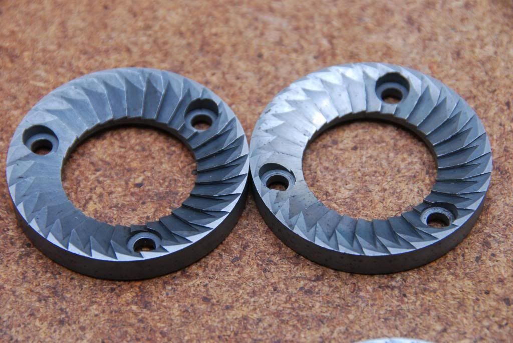

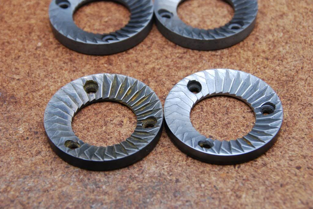

    Still waiting for the Doser parts to return but in the mean time, the new burrs have arrived and even visually you can see the difference in sharpness between the 2 sets.
    The first picture is of the old burrs:
    These are the new 54mm burrs:

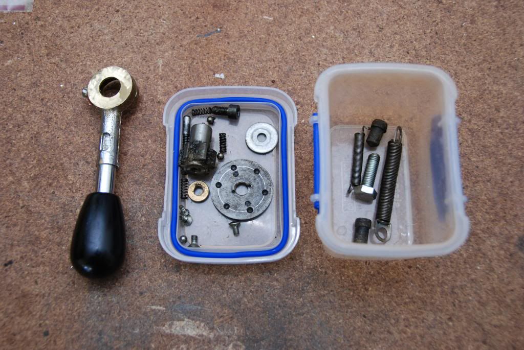

    The next photo is of the disassembled doser mechanism. Quite a few parts - with plenty of springs, bearings and screws!

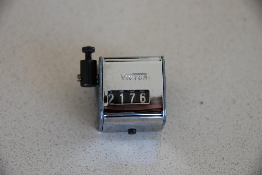

    The last one if of the shot counter - I took this out and gave it a bit of a clean up. It wasn't counting when i took it out, but it appears that the black lever pin just needed tightening so that the ratcheting mechanism worked. It's a little cleaner now. Shot counter said 2132 before I started cleaning. Hard to know exactly how many doses have actually occurred though.

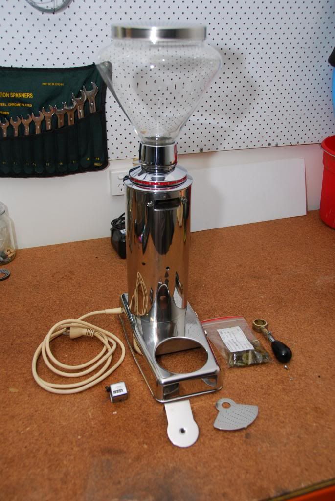

    Just a few more photos of the main body section all cleaned up just awaiting the doser.
