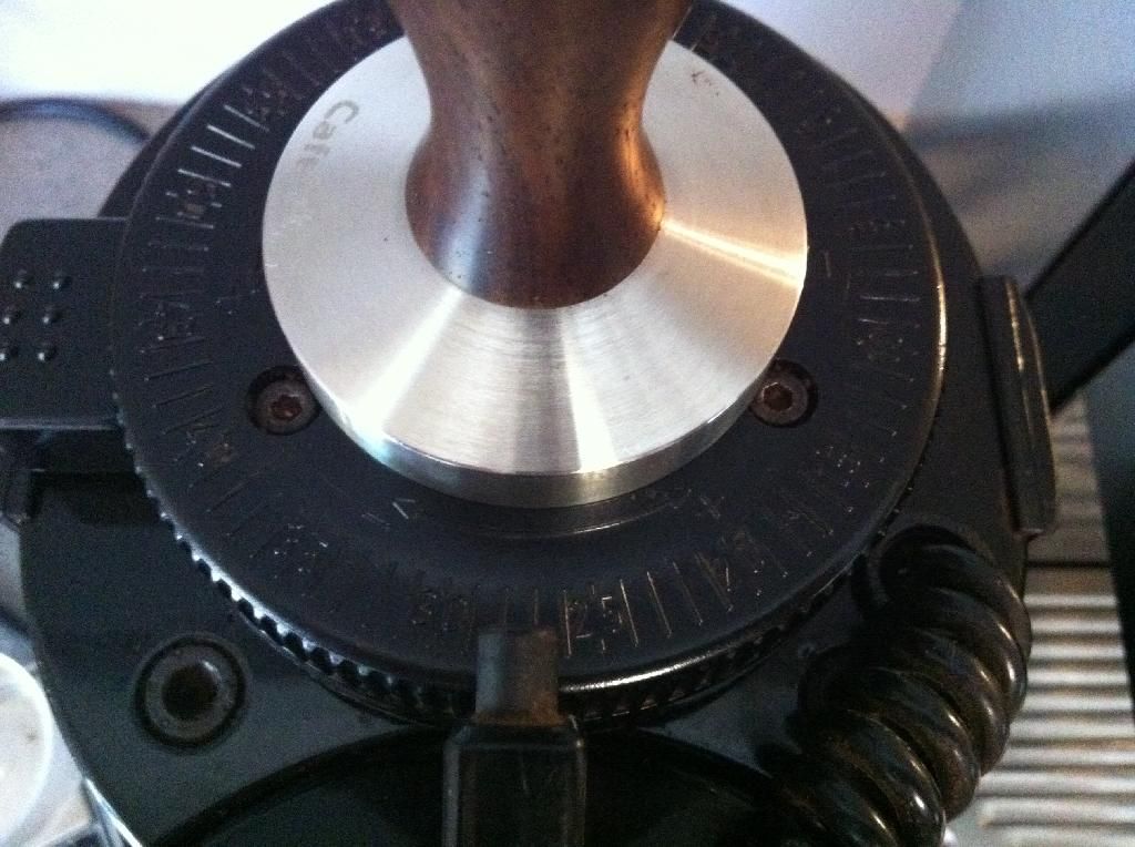

    You have been helpful but I think it should be mentioned that not every service provider will bother trying to align the adjuster ring to obtain an "absolute" zero setting on the scale, at the point where the grinding plates touch, when replacing the plates in service.
    This means there are thousands of these grinders out there where the number on the adjuster scale cant be compared to any other grinder of the same type, for a similar grind setting.
    And that's ok, because it doesn't need to.
    What is important for the operator (barista, whoever) to know however, is that to reset the grind after replacing the plates, all that needs to be done is to wind the adjuster all the way down until the plates touch, then back off say 1/3 to 1/2 a turn, grind some coffee, make a brew, and reset for fine adjustment. It wont be far out. Whatever number it ends up on is irrelevant in the big picture, because it is up to the operator to know what he/she is doing and rely on his skill to find the right grind setting, rather than to stick it on an arbitrary setting and hope its right.
    In effect the number on the scale your individual grinder ends up on, is relevant only to you in that you can make changes according to the supply of beans, their age, and ambient weather conditions, and know what your reference starting point was.
    Hope that helps

    Hey rob,
    I've had and do own both of these, although I'm not using the sunbeam anymore I am using the same grinder..
    I think it's worth pulling the grinder blades out and make sure they're not gummed up with old coffee.. This used to happen to my rocky and it just ends up giving a real inconsistent grind,
    Clean them properly..
    Zero the grinder, disregard any arrow or marking and make your own (white marker or a price of tape) something you can gauge the grinder by yourself, then start working with your grind..
    To get a good coffee out of my 6910 with the rocky the blades were always touching..
    Just my opinion

    started a topic Gino Rossi RR45 blades
    Hi all
    Just purchased a use RR45 grinder to go with my Sunbeam EM6910. Here is my problem, To get the grind fine enough to get a good pour the blades are actually touching. While this is not good my question is do the blades need replacing? Also what mark is using to align the strokes / numbers on the adjustment collar? I`m guessing it's the lug on the top of the doser lid? If this is the case the grinder is on about setting eight. Any advise is appreciated.
    Rob
