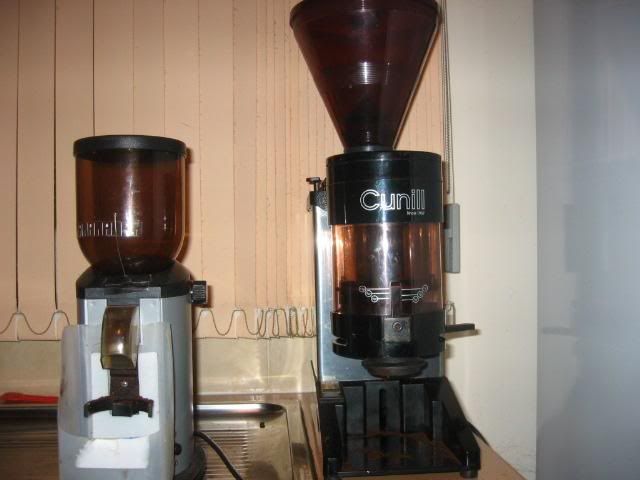

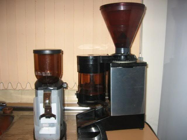

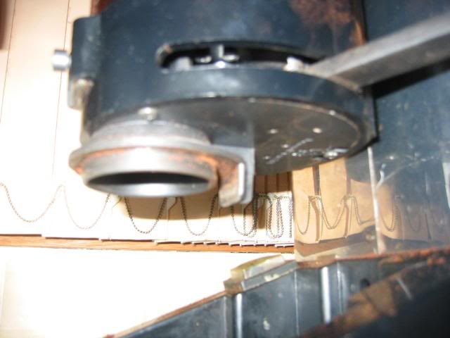

        Here are some pics:
        David and Goliath wrestle for space near the sink.
        Danny de Vito and Schwarzenegger with its stainless steel body
        The portafilter cups around the exit chute

        And the Iberital with its milk carton mod to stop stray grinds

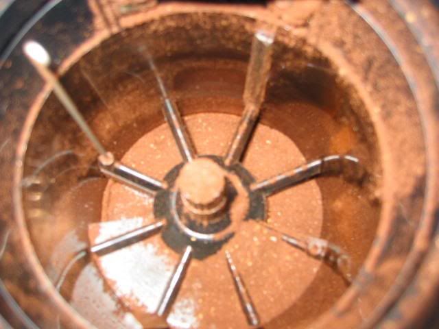

                            Ive noticed that there is an initial blast of fine grinds dust into the doser. This is sprayed out all over the place.
                            Then things settle down, and the grinds start to fall neatly straight down.
                            I am making sure there is a segment directly under to catch them. When that segment is full, I pull the dosing lever to move the next empty one into position.
                            That is giving me a better idea of how much to grind. Of course, I have to keep lifting the portafilter away from the neat exit chute to check, and everytime I do that some grinds spill out. Messy.
