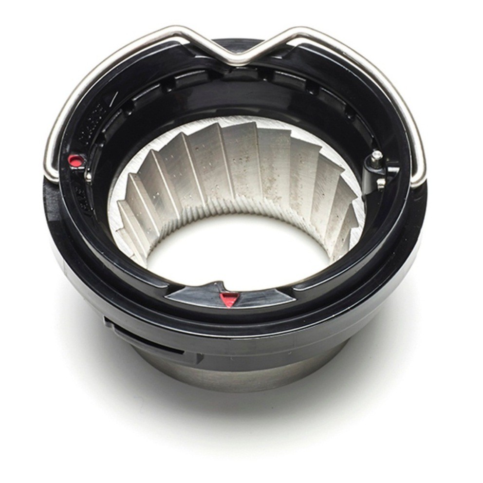

        Yes, in my travels I did indeed spot many youtube videos / manuals referencing this adjustable upper burr that supposedly solves this issue, but my burr was not adjustable. My manual even (yes, I saved it!) is different to the ones I found online for the BES870/BES870XL.
        The burr I got with my machine looks like this: https://images-na.ssl-images-amazon....yQbhL._AC_.jpg
        This is the "latest" gen burr with adjustment: https://cf.shopee.com.my/file/ec1128...b44dd9625cb061
        I contacted Breville support - they are sending me a free shim kit. I take it this "shim kit" is just a bunch of washers that go under the middle burr (i.e. the biggest one) in order to raise it up a little bit? I've also asked if they can sell me the adjustable burr so I can upgrade my machine.
