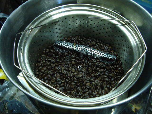

    The skirt was part of the strainer and was cut off. I was lucky that it was stepped in a way that suited using it as a collar for the bean bowl. It was a $50 kit from K-mart, came with a pot, glass lid etc.
    I used a 9 inch grinder with a cutting disc (only because I couldnt find any 100mm cutting discs for the small grinder) then i cleaned up the edges with a bench grinder. Cuts were not that neat, and they dont need to be because of the strainers design (bit hard to explain) but it was quick!

      Stole handles from the steamer insert from the Spaghetti cooker kit and put them in the roasting insert, modified the agitator too. Its ready to roast!!!!!!!

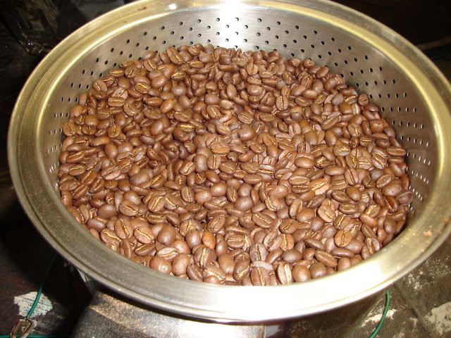

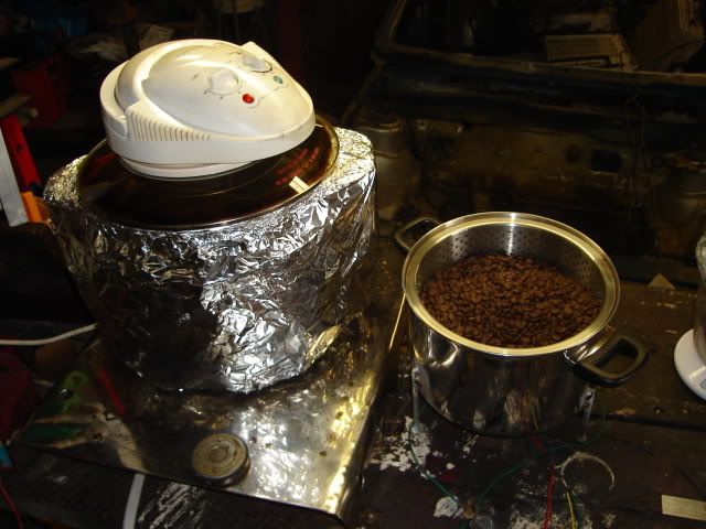

                      Just thought Id add an update of the turbo oven roaster now after a few months of moderate use.  The roaster has done at least 13kgs in total without any problems. I have been using the CS multimeter and probe for the last 5kgs or so, which has been a great tool to assist me with improving my roasts.
                      I have raised the false floor to reduce the chamber size by about 1L.
                      Here is a photo of the insulated roaster (-about 15m of aluminum foil wrapped around the pot) and the bean cooler. The unit seems most happy with a charge of around 375g.
                      Here is my latest roast 375g of Colombian Supremo
                      -Flash has taken some colour out.....
                      • #26
