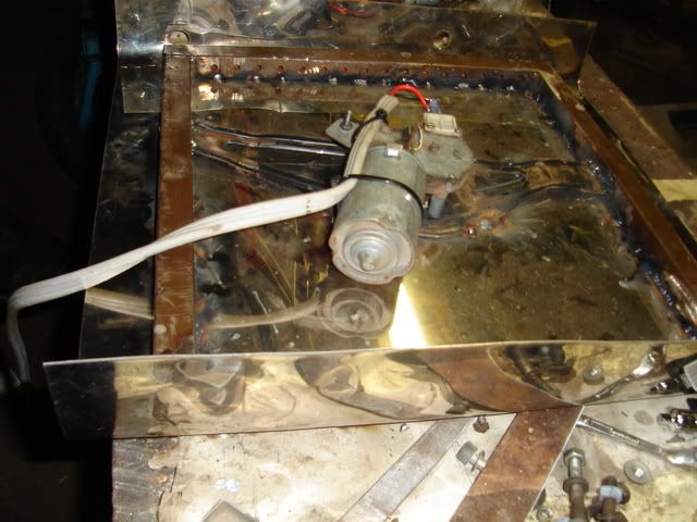

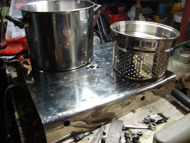

    started a topic KK inspired roaster build
    Today I bought a Tiffany turbo oven , a stock pot and and a spaghetti cooker (thanks for the tip KK). I started putting it together using some a stainless steel sheet i had lying around, and some 1 inch square tube. I also salvaged the windscreen wiper motor from my DNF mixing bowl project.
    Here are a few pics I spent about 3 hours on it today, main time was spent cutting materials......I tack welded the sheet to the frame.
    It does look better in these picks than in real life. I bashed the 2mm stainless sheet around the steel frame - buckled with hammer marks and all!
    Anyway, I will keep posting as I progress.
