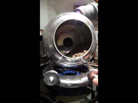

    And here's a video of it in action

    I manage to grab the roaster listed under Pay It Forward, offered by "friskhr". Much appreciated
    It was pretty cool to use. At the same time, I didnt really have any idea what was happening inside the chamber in terms of heat and any visual cues. I just had to go by gut feel and the cracking noises.
    I dont know how fast it actually spins, but if it's 4.5RPM then I think it's definitely fit for purpose.
    I did 200g and that went for about 18 minutes. It hit 2nd crack as I was pouring it into a colander. Here are some photos I took.
