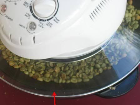

    - The oven lid overlaps by about 7mm which doesnt cause a problem, nearly every photo I have seen of other projects shows a small overlap. Heres a photo I didnt put in before:
    - at the moment the chaff/smoke mostly escapes through the gap, but if I add an adapter ring, I guess I will have to think of something else.

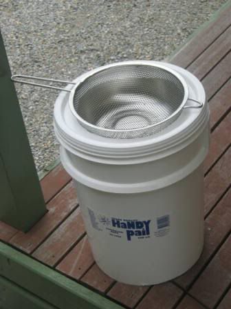

    My Stir Crazy just arrived and havent had time to open the box yet. Youve probably saved me a kilo of coffee and a couple days roasting with your research. My cooler looks similar. Mines a ceiling exhaust fan wedged into the bucket about 1/2 way down. Have holes around the bottom of bucket for air intake and fan blows out through the beans.

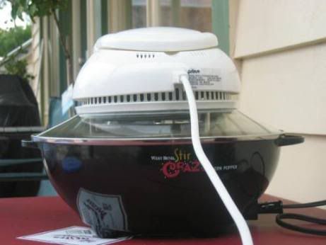

    started a topic StirCrazy CopyCat
    StirCrazy CopyCat
    I know this is not original but they say imitation is the sincerest form of flattery.........
    My StirCrazy finally arrived last week and I set about quickly doing the necessary mods before roasting.
    - disconnected the heater.
    - replaced plastic nut with nut from 8mm dynabolt.
    - covered nut/rod with alfoil, then a brass pipe-cap.
    First roast (Friday night) was fast, hot and uneven with some beans oily, some light.
    Roaster was too hot and I added too much coffee (400 Grams)
    Pre-heated to 200 deg C, 1st crack was not happening, cranked to 250 after 14 minutes and everything happened way too fast after that. disappointed with the outcome but put it down to inexperience.

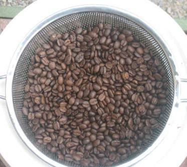

    Second and Third roasts (this morning) look like a roaring success and I have posted the pictures here:
    Coffee = Brazil Yellow Bourbon Pocos De Caldos
    Quantity = 300 Grams (for each session).
    Temperature = Pre-heat 5 mins to 220 deg C, crank to 230 deg C after 1st crack.
    1st crack = 9 mins
    Rolling 2nd crack started = 14 mins
    Finish = 16 mins
    This is the most uniform roast I have done thus far and I am able to do 3 times the volume in a single roast than I did with the air-popper.
    The Beast awaits:
    Time for Cooling
    The Cooler
