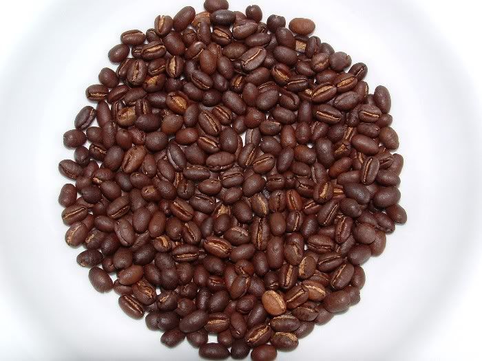

    Re: Breville Quick Popper Popcorn Maker
    I seem to remember Hazel saying something about the speed of the roast not giving enough time to cook(?) (my word) the sugars(?).
    Anyhow, fingers crossed, waiting patiently now to taste.
    Originally posted by Thundergod link=1155880692/0#9 date=1161841035
    They dont smell very strong.
    Would that be usual?
    Generally I find around a Full City roast (bit hard to tell from a photo - but thats my guess at your roast level) there isnt as much aroma..... but that also varies from bean variety to bean variety.
    The aroma generally seems to get stronger towards a Vienna roast..... and after that it just smells like the beans have been burnt!!!! (Smokey charcoal)!!
    I also have found the speed of the roast seems to make a difference to the aroma after roasting (probably because of the amount of volatile oils remaining on the surface of the bean......)
    To be honest, I dont worry too much about the strength of the aroma..... I just wait patiently to see what they taste like in the cup..... Only ever had one really bad one (and I knew that before I tasted as Id pushed the roast quite a bit too far!!)
    Thanks JavaB.
    Probably watching Hazel yesterday helped.
    Ill probably be going to Vivianes for more input.
  • JavaB
    Good one Thundergod!
    Yep those beans look great .... a few slightly less roasted is not a bad thing as it can add to the overall flavour....
    The proof will be in the cup in a couple of days.
    I just did my fist roast of a PNG Peaberry from my starter pack that arrived this morning.
    I was looking for a heat gun yesterday but Bunnings were annoying and Hazel showed me a 100gm roast in her B&D after she did a 3kg roast in the commercial roaster.
    It looked so easy in her popper that I decided Id start out that way.
    Got myself a Breville Crazy Popper from the Factory Outlet.
    Ill only be roasting in emergencies (running low and Hazel AWOL).
    My timings are non-existant / rough.
    Not sure about start of 1st crack but rolling stopped and I ended roast just shy of 5 minutes with 100gms of the PNG Peaberry.
    There seem to be a few beans slightly lighter than the majority but mostly the batch looks OK.
    What do you think?
    With flash.
    No flash.
