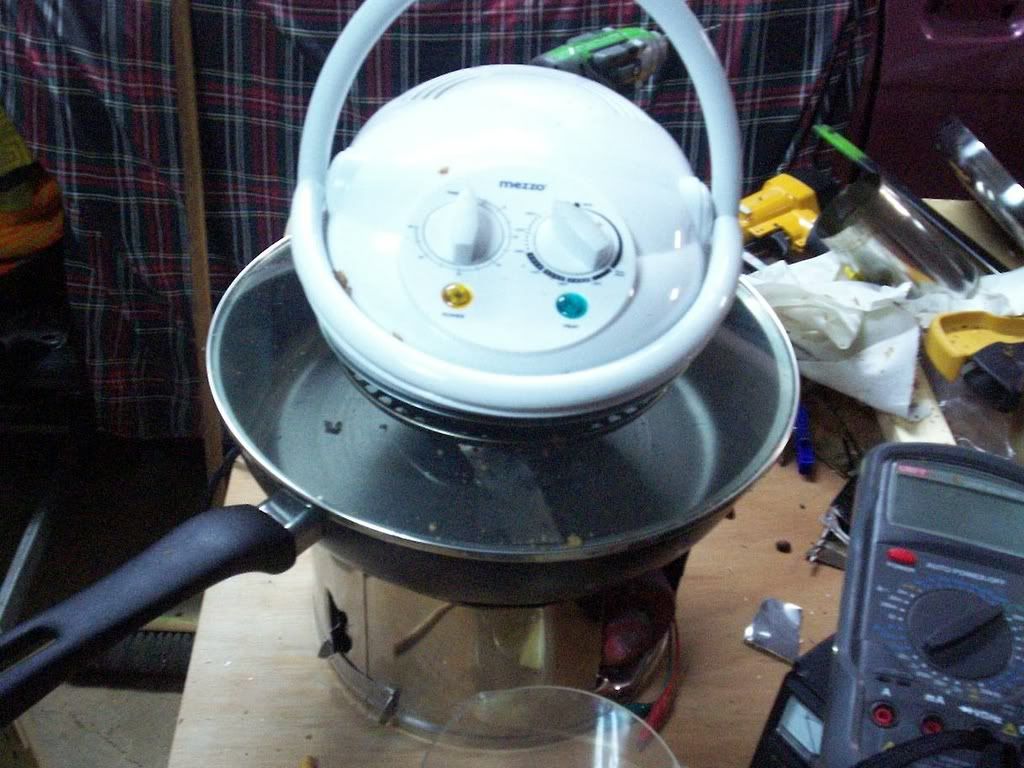

    Finally starting to get use of my right arm back, I managed to get trial runs of the new frankenroaster built from a hot air convection oven lid and my partners favorite frypan a windscreen wiper motor, paddle made from scrap metals, and a bloody determination to roast more then 120gms per batch in a popper!
    First test batch was done with brasil monte alegro 250gms and took 12 mins to roast to just into second crack, second to start testing upper limits was at 400grms eithiopian limu.
    Paddle mech handled the 400 grams easily and I think I can push it to about 600700grms per roast!
    Man am I excited and happy

    So far the two test roasts look and smell great still some work to do with regards to chaff removal but its getting there and I can finaly roast larger batches!!!

    Should we call this device a Frypanstein?
      Re: New from Sullos Labs
      umm maybe "Frypandenstein"!
      An here was me looking for a saucepan to mangulate to the right size then she who has great ideas said what about that flat fry pan I use all the time? Brings it out and presto PERFECT size to match the heat lid doodat. I had to replace her frypan with a new one so all up this device cost me 60 buck, oven thingy included!
      Not bad for a 600 gram roaster!

            yeah chaff was still in the mix esp with the limu, it was a new bean so Im going to cremate that one a bit longer sometime today, as with popper I have some learning to do with roast times etc, the tiger mountain turned out superduper thou.
            Im going o mangulate the frypandenstein later today with a chaff ejection port which should do the job better then the odd raising of the lid and letting it fly everywhere
            Also the tiger mountain worked better when pan was hotter, other batches were from cold and took at least 6mins to get to around 200C so today experiements will involve preheating which also made my popper roasts better too.
            My work is never done

                Sullo, $60 all up?
                Aldi are selling the heat lid doodads this week for $60 new.
                So you got it 2nd hand then?
                I thought about it but wasnt sure if it would crank out enough heat.
                The frypan though is a great idea as it lower the heat source closer to the bean mass.
                I was also worried about chaff removal so keep us posted as to how this all pans out (pun intended).
                  nope they are 49 and the replacement frypan 9.50
                  Im still working on the chaff ejection wil post when finalised.
                  Mal, working in the paddle it looks ugly as hell but it works great, lots of adjust swearing adjusting. The method was to spray paint 250grams of old beans in 50 gram lots in different colours, put them in the pan and switched on in their seperate colours, it was about 4 rotations before all beans were mixed so Im pretty sure that Ive got that bit sussed out.
                  Chaff is more problematic as Im trialling a way so I dont loose too much heat and remove the chaff that tends to get sucked up into the turbo blower doodat.
                  But working all these things out is half the fun..
                  And why? Cos I want something that roasts more then a gene or hottop which i was going to buy.

                      I thought about using a frypan once, but I decided it wasnt deep enough. Now I have a pot thats a bit too deep.
                      A turbo oven is a great heat source. The only downside is chaff removal, but that may be done with a small slit that chaff can exit, but beans cannot.
                        Ramking, lol you got that right!
                        Nunu I had same problem, I was using a cutdown stainless pedal bin and was cutting it down inch by inch, then along came the one that has great ideas and the frypan with its perfectly matching circumference and height came by,
                        now with some parts from the heatgun I melted recently Ive almost completed prototype catcher hope it works final testing when I get time.
                        Thanks for the interest guys
