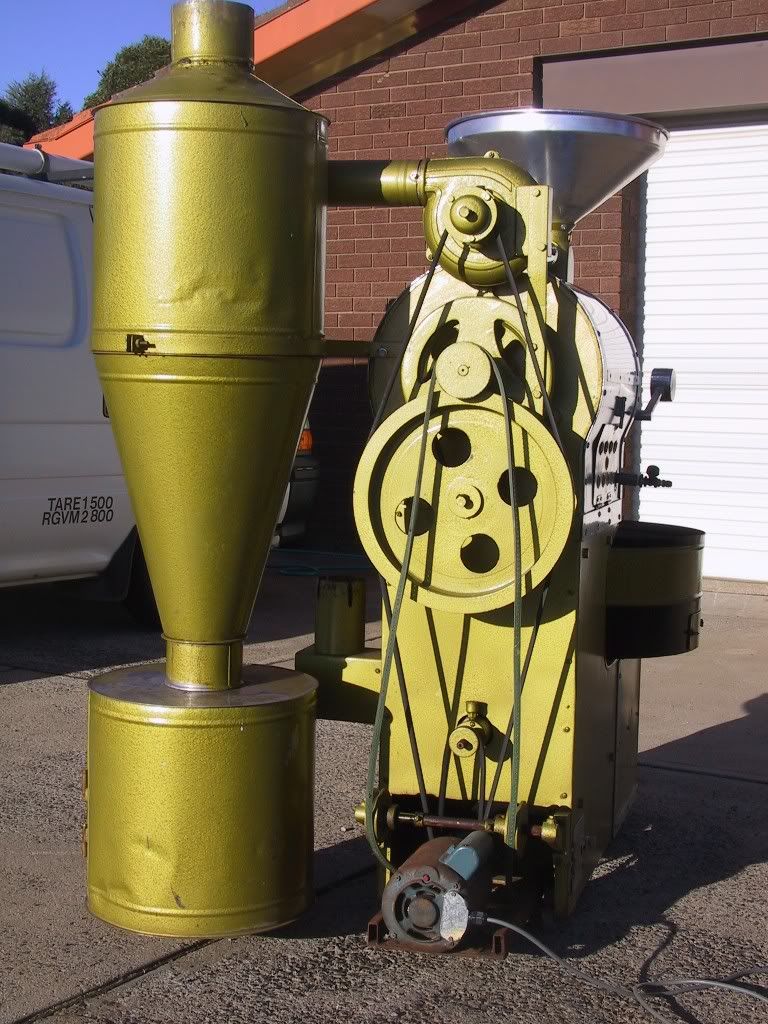

    Looks can be deceiving HV...
    Dudley actually has 4 fans - some push and the others pull. The stove pipe in the pic leads into a fairly large, baffled, chamber (for chaff collection) with the exhaust fan at the other end of the chamber.

    OK on the serious side most commerial roasters pull/suck air though the roaster
    Just look at the following examples
    Poundys roaster for instance REAR & SIDE
    And Denniss roaster although it has longer pipe work between the drum and the fan pic of its REAR
    Temperatures are on a concern however shouldnt be a problem.
