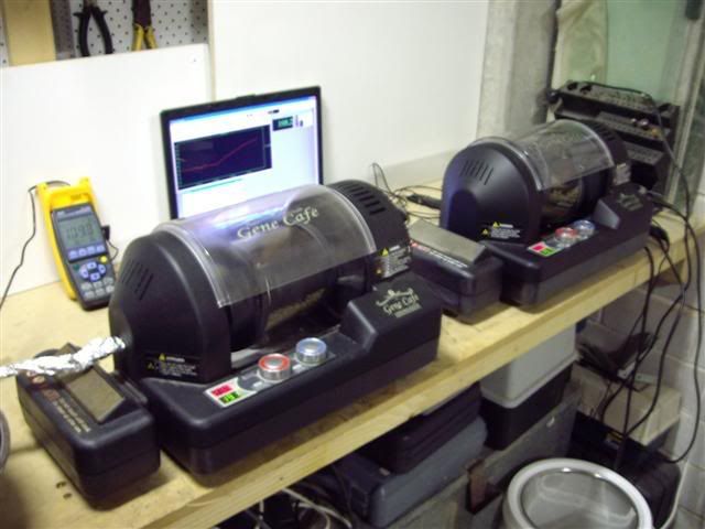

                    By the time you finish Remy, it should look like this...
                    2mcm is just a phone call away.
                    Sorry - the devil made me do it! :
