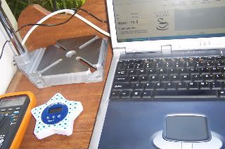

My new Coretto setup
  • My new Coretto setup
    • Aldi drill stand with reversed handle N.B. no adverse affect from heatgun on drill holder.
      Bosch digital heatgun
      Breville BB280 bread machine
      Digitech QM1538 with flexible probeless thermocouple attached to tent peg with fibreglass heat resistant
      sleeving to keep it rigid and further protect from heat sinking
      Fan from recycled rubbish on footpath
    • Side view of setup showing bean cooler made from the pot of my now terminated TO roaster,  hot glued/sealed to a sieve/collander with extra holes drilled and sitting on my TO roaster stand (the "Sputnik") then attached to discarded vaccuum cleaner. Works great!
    • Laptop computer running Coffee Snobs roast software connected to DMM etc.
      Star shaped digital timer from my "popper roast" days for quick reference
    • Top view of inside of bean cooler

    Great setup Cremakid, i find the bosch heatgun fantastic.I can ramp up the heat then When it gets to about 250deg C in my roaster i lower the temp of the heatgun so as not to Roast to quickly.
      Re: My new Coretto setup
      Looks good! Might not fit in with the corner setting though, but maybe put the fan on the other side, so that the chaff doesnt blow towards the heat gun or head towards the laptop keyboard.
        I wont normally be roasting in that corner position. I was desperate to try it out so just set up everything on the front verandah. I had no probs with chaff etc.

          I agree with PhilMac re the fan position.
          Mine is behind the HG.
          You say your discarded fan works?
          I usually recommend looking for them for just the pedestal.

                I have the same set up except for the heat gun. I bought my stand from Bunnies. I found that I needed some weight on the drill stand to stabilise it. I use a milk bottle full of water. Great set up.
