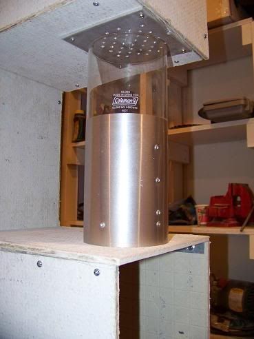

            Heres a better idea of how the front will look.  There will be some gaskets above and below the hopper.  Slow progress....
            CHAD
            • #21
              Re: CoffeeAir - 1kg Indoor Electric Roaster Trial
              Hi Chad
              I may have a mod for you to better control heat and air flow (at the heat tube)
              It is a Hi Clone insert I am sure you can get them in the US (a car part)
              By inserting it at the bottom of the heat tube you will create a controlled turbo effect of the moving air over the heat coils
              The turbo effect will also give air stability to the bean mass as it passes through
              It is my belief that this mod will work a treat
              You should at least consider the possibility

                          Thats a nice looking project you have there, Seedlings. Im just curious as to why you havent gone with a "sprouting cone" type design instead.
                          • #28
                            You mean, like Sivetz uses?  http://www.sivetzcoffee.com/drawings.htm
                            I wanted a removable hopper like the www.sonofresco.com, but dont want to waste heat up the vent.
                            Plus, cylinders are much easier to fabricate than cones. Especially hard without fabrication equipment. Although my first roaster did use a cone.
                            CHAD

                              Yep, like the Sivetz, or on the home roaster front - like the designs that RoasterRob has built.
                              Im not sure I understand what you mean by "waste heat up the vent".
                              True, probably harder to fabricate.
                              Doesnt a sprouting cone design require less airflow to loft the same quantity of beans? Therefore a smaller (and quieter) motor can be used, which has to be a good thing, doesnt it?
                              Actually, I saw a "sprouting cone" type of fluid bed roaster in a store in London when I was there last week. I shouldve taken a picture of it. I really liked the design. The roasting chamber was glass so you could see the beans. The roasting chamber wasnt removable, but it had a lever to dump the beans out the bottom. Hard to explain on here, but it looked like a very clever design, but would be a bit difficult for someone to duplicate at home without access to some fabrication equipment. It had a cyclone type chaff extractor attached to it too. I didnt see what make it was, but Id love to get my hands on one. No doubt itd cost a fortune though.
                              • #30
                                Im not sure Rob in New Zealand uses a cone, does he?  I was under the impression he uses a flat perforated plate because he likes the asymetrical flow rather than the "pretty" flow.  Rob said it seems more effecient to him.
                                To quote RoasterRob on 1/22/2008:
                                "The beans flow very smoothly across the roast chamber, this is an assymetrical type RC (havent used the cone one yet). Blower is a 1.1kw cheapo vacuum cleaner motor bout 5" dia and only 4" high. We have fluidised 3kg with one blower."
                                -heres the source, http://www.homeroasters.org/php/foru...71&rowstart=40
                                By "waste heat up the vent" I mean the heat that goes out the top of the roasting chamber, and into the sky or a vent hood.  Im trying to recirculate the heat, therefore requiring less energy.
                                CHAD
