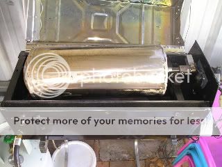

    what are your thoughts on perforating the drum?
  • matt_Hellyar
    Re: Birth of the Bruce
    nice, cracks should be loud and clear then.
  • coffeelust
    Thanks Matt, We did one of around 600g but beans were being thrown out. However, now that we chock up that end of the stand a little it seems not to be a problem, so will try a big batch soon. The new rollers, with ball bearings, are much quieter, so now it is just the whir of the motor and the rattle of the beans.

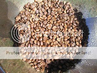

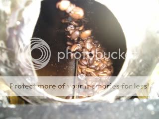

  • coffeelust
    here are some pics from this mornings roasts. Our son was nearly late for school because we were fiddling around with this (oops)

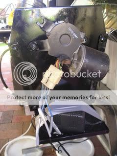

  • coffeelust
    Thanks Matt
    cameras on the blink at the moment, but should get some pics up soon.
    In reply to your question re noise on another thread, I think its from the rollers at the far end of the drum from the drive shaft. Rather than a bearing like yours, mine has a pair of bronze rollers. Did you have to get a special heat-tolerant bearing?

  • coffeelust
    started a topic Birth of the Bruce
    Birth of the Bruce
