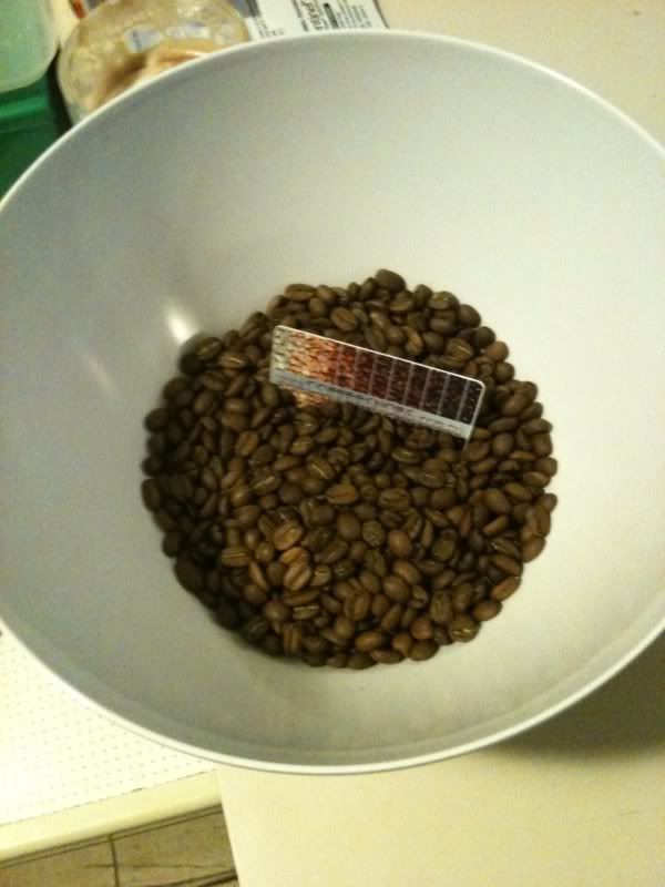

                            Well I got around to doing another roast tonight. 225g Peru on settings 1/2lb, P2 B. First crack at around the 8min mark, second crack starting around 90seconds later and pulled with just under 3 mins left (10 minutes in). Final weight was 195g and it came out at about CS8/9. (sorry for the dodgy pic. Stupid iPhone camera) Would have preferred it a bit darker but this was certainly better than my first attempt. This roasting business is good fun
