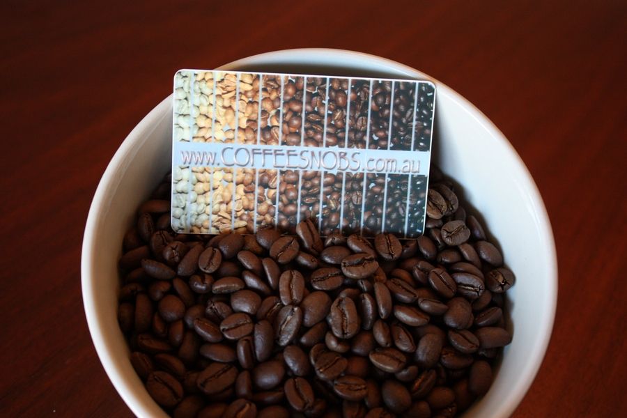

          Well I just unpacked the Behmor bought for me by my lovely missus as a xmas present!
          Ran a dry burn and then roasted 200g of Elephant Hills with Andy's settings above.
          This is the first time I've ever roasted coffee so not entirely sure what I'm looking for!
          I heard 1st crack with 2.30min left on the timer and this seemed to go till 1.05 left then silence. With 0.23 left I heard a few cracks before the cooling fan came on and then a few more after but very sporadic not at all like 1st crack. Is this normal? Do I need to extend the roast slightly?
          Image of beans attached!
          Mick

            Hi Mick,
            That sounds like your roast reached 2nd crack (2C) at the 0.23 mark. The Behmor manual quotes a "Rosetta stone" key tip for anticipating when 2C will occurr which for a 1/2lb roast is 2:10 minutes from 1C. You reached 2C in 2:07 so pretty much spot on.
            1C normally has louder/sharper cracks where as 2C to me usually sound more like pops and are quieter.
            If you want to go darker you could add time in 15 sec increments by pressing the + key while the roast is running. Once you have reached 2C you need to take care not to over roast which can happen quickly. Behmor advise that it takes around 15 secs for a roast to reverse to cooling after you reach the cooling cycle or hit the cool button.
            Read the manual carefully as there is lots of good information to digest.
            For instance 1/2-P2-START is actually the 1/2-P2-A program which has a roast cycle of 12:00 minutes. 1/2-P2-B roasts for 13:00 minutes and 1/2-P2-C roasts for 14:00 minutes.
            1/2lb is actually 227gms so 200gms will roast slightly quicker. If you want to try slightly darker with the 200gms I'd use the 1/2-P2-START and press + once when the timer starts flashing, to add 15 secs to the roast cycle. Watch the color of the beans carefully and hit COOL if you feel they are going too dark or you start smelling a sort of smokey/sharp smell which could be the chaff or beans starting to scorch if you have gone too far. Tread carefully and add time in small increments if going into dark roast territory. Much better to go slowly than be trying to clean/repair a blacked out roaster after a fire inside!
            Your taste buds should guide you when deciding how dark to go. It has been said that with the very dark roasts you taste the "roast" rather than the character of the coffee bean.
            PS Forgot to mention that you need to follow Behmor's maintenance instructions of cleaning/dry burns to ensure roast times stay consistent. Don't let oils/residue build up especially in the area of the sensor as per Behmor's web-site tips.
