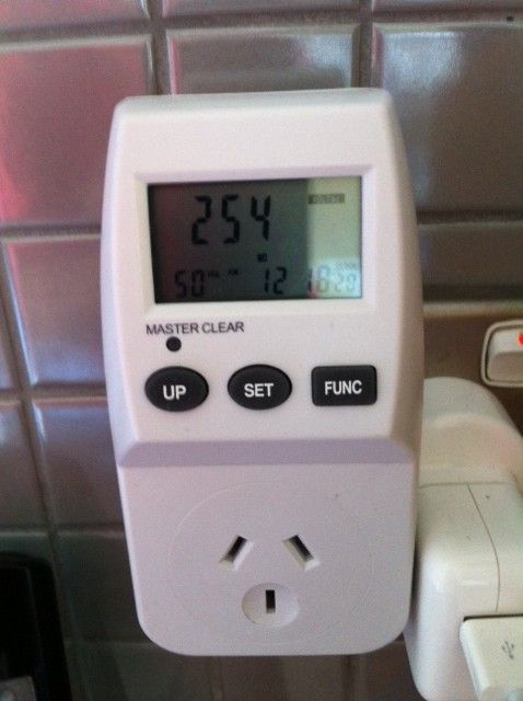

      Divey, consider buying one of these cheap gadgets ( $20 jaycar, DS etc) and make notes about your supply voltage in the home so you have some data when you call them. note mine is reading 246 in the morning but usually drops below 240 after lunch.
Name:	power meter reader.jpg
        [ATTACH=CONFIG]2155[/ATTACH]
        What are they called, I'm guessing a 'Supply Voltage Meter'.

              • That Jaycar meter is a neat gadget. I have one, which will measure volts, amps, and watts, and cumulative watts used by an appliance. I like plugging my big-screen tvs in to it, and watching how the watts go up when the screen lightens. But I digress...
                The one big issue with the gadget is the tiny, tiny, tiny readout. I need a magnifying glass to see whether I am looking at watts, volts or amps. Ridiculously small to the point I rarely use it.

                  I think I scored mine from Catch and it has a much larger readout than the Jaycar one, and is programmable with cost as well (so you can see how much a particular appliance costs over a set period). IIRC, they were original part of a QLD government scheme and were then sold off to Catch?
                  Anyway, there a few different models out there, and some include remote monitoring. Seek and ye shall find!
