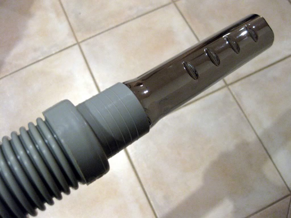

          Thanks Sully. I found the pool tubing in Bunnings, $8 per 1mtr section, and they plug into each other to extend the length. I also cut a 6inch section off the end of an old steel vac pipe I had lying around at home, and used that for a nozzle. (which also slips nicely over the fitting at the end of the hose)

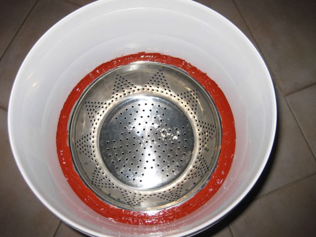

            Thanks to others here for the design.   I forget who it was who posted the hand drawings for a cooler with a bucket and an old milo tin....

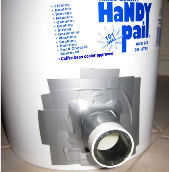

            Anyway, heres the pics....   I originally permatexd all the sealing joints but had to tape them up too due to the silicone not sticking real well when flexed.
            Top view of the collander sitting on top of a 9ltr bucket, inside the 20ltr bucket.
            The pipe at the bottom of the bucket is 40mm PVC from bunnings, with a 3mm rubber insert to match the smaller size of the vac handle.
            I cut a six inch length off the end of an old steel vac head / tube.
            It made a great heat proof nozzle, and it was a nice fit into the fitting on the end of the pool pipe.
