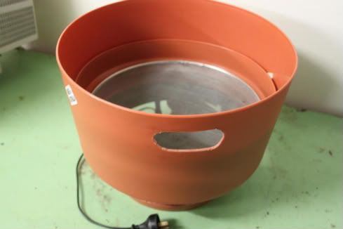

Parts
Ceiling fan - Donated by my dad as he had one in the shed
Flowepot - $2 shop - $10
splatter guard - $2 - $2
Draft seal - Hadit in shed
I put this unit together with what I could lay my hands on, after a look tonight, I was suprised to see it is very similar to some others posted on here. I originally had a vacuum model, but after upping the roast size to i kg I couldnt cool quick enough, and started having problems with melting hoses etc, so went ceiling fan. This is totally air tight as I weather stripped it, when you dump a full load straight in, it nearly stalls the fan, I usuall just feed it in a bit slower - it cools in 1-2 mins. Again, I just upend it, and the beans drain through the handle hole into a colander, then bag it.

Parts
