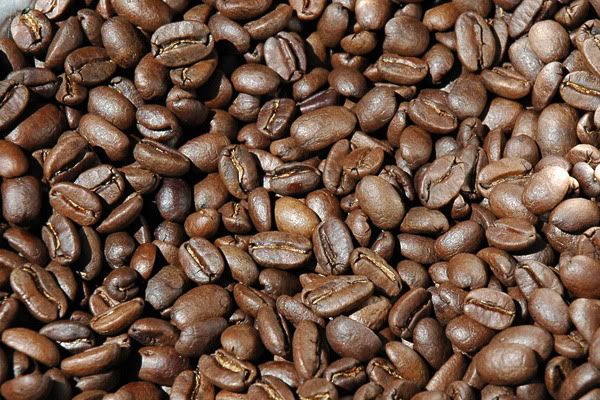

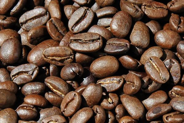

    I was looking up "tipped beans" and "divots" and came across a forum post where someone said this:
    "If theres more than about 1% moisture left in the beans, youll get divots too."
    That made me remember further back in this thread where someone said that the different way of roasting resulted in a less drying roasting method (than hot air). I wonder if there is any connection.

    Hi, thanks for your comment. I am going to have to look up "tipped beans" and "divot". I read a thing on the web yesterday that said some bits popping out of a bean was part of second crack. Thats what I thought that was (the sort of pit thing).

    Congratulations on your first roast Sidoney!
    All looks good, but I think I see some tipped beans and a divot. This can occur if there is insufficient agitation and/or too much heat applied.
    I hope you enjoy the baby roaster and the journey to home roasted nirvana!

    I took delivery of one of these yesterday. It was going to be a manual one but thanks to a packing error and Marks generosity I have a motorised one.
    I have never roasted a coffee bean before. I read this thread before trying it.
    Yesterday I did my two sacrificial roasts. The first one to "burnt offering" stage. They were "Peru Casa de Selva Estate" from the beginner sample pack. Today a larger quantity of that arrived and I did my third roast, the first "real" one.
    Yesterday I had some trouble distinguishing the stages but today it all seemed very clear. I could hear first crack, then a gap of no cracking, and then second crack. I took the beans out shortly after the start of second crack.
    I am going to have to be less cautious with heat, instead of ten/fifteen minutes, first and second crack were closer to fifteen/twenty-odd. I didnt closely time it, just kept an approximate watch on the time. I really LIKE the interaction with the roaster and the beans. I also like the small roast quantities, because it means being able to learn and change instead of having to commit to a lot at once. (And I have a lot to learn!)
    I had a cup of coffee from it. And I have to say, if this is just the beginning, I am looking forward to the journey!
    I took some photos. These were taken in sunshine. I did take some in shade, and shade with flash, too. Not sure what is the preferred lighting source for posting. They do look different depending on the lighting. I hope I can get one of the colour comparing cards soon.
    (Have not posted photos to this forum before so I hope this works.)
