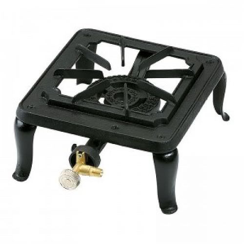

    has anyone used one with one of these?

                          Re post 315....burner.
                          Im using a similar burner.....slightly larger,using only the two internal rings...it has three.
                          I find there is much more flame control compared with the camping stoves (have tried a small companion and a larger coleman).
                          I monitor the flame on the larger cast iron burner using height and colour....blue (low) or blue tipper orange for higher heat.
