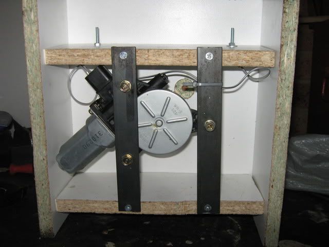

Started building this yesterday and finished today at around noon. However, Ive spent quiet a few hours in planing the execution to suit my particular application. As you can see, Ive used a terracotta pot as the centre piece for good thermal retention. Underneath I had fabricated a sub-frame to house the agitator engine, which happens to be an automotive power window motor. Power supply comes from a battery charger thats been flicked to the 6 volt setting to reduce agitation speed. The hard part for me was do I put the motor inside the pot to drive the agitator, or do I make an extension to have the motor outside to isolate it from the harsh heat! The second option was my choice of path, but that meant it needed a long shaft and a means to support the shafts ends to prevent sideways thrust.
Luckily I had an old XF Falcon distributor which I was able to locate it inside the pot. The stainless steel bowl sits on top of the distributor and is fastened to it for stability. One headache was making a coupling to link the motor to the distributor drive - after about an hour cursing I made a coupling that allowed a little bit of freeplay between the joints to compensate for any possible misalignment - in doing that I minimised any extra loading to the motor which would have otherwise caused an increased current draw. Fully loaded with 1/2 a kilo of beans the motor draws around 2 amps @ 6 volts.
