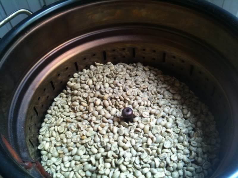

    1.2kgs Yirgacheffe....................................... .
    This is the largest roast Ive ever done in the KKTO.    I actually tried 1.5kgs, which Ive no doubt with the switching mod is doable, but was a little too much for the agitator motor.
    Anyway,  1.2kgs was a breeze.    Have to rethink my combo vac/cooler system now though, as the larger batch overheats the vac motor when cooling.
    Heres some pics.  Apologies for the quality, taken with an iphone.  The dig camera battery was flat....

    Hows this for a full pot

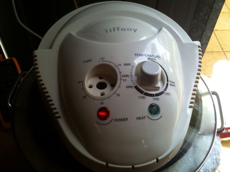

    Frankenturbo after brain surgery....  The relay is mounted where the timer switch used to be.   Thats a light dimmer in place of the temp dial.

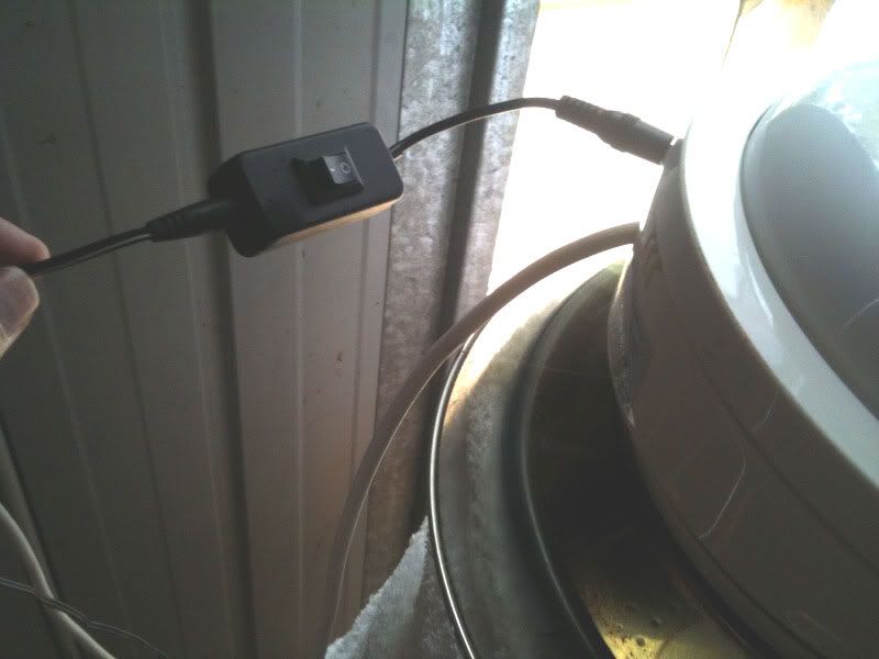

    Element switch.    Probably better positioned off the side somewhere.
