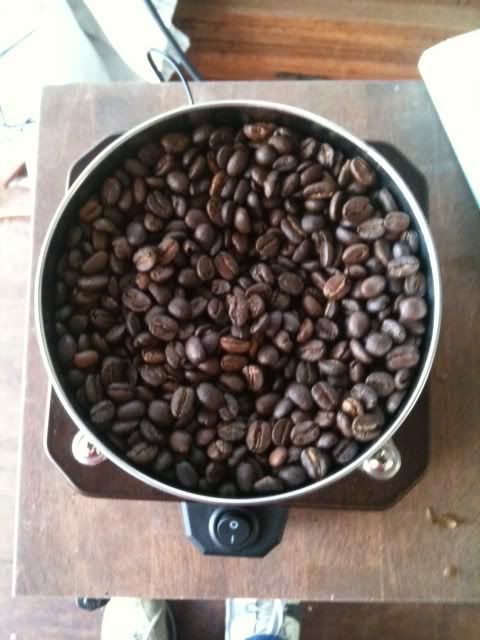

            This is what I do my cooling in. It is a small seive thing I got as part of a set of 7 sieves for $10 from my local foodworks
            and after a 250g roast of 200g Tanzania Uru and 50g PNG eastern wilds
            Cools the beans down in a couple of minutes, much quicker than trying to cool them in the pan
