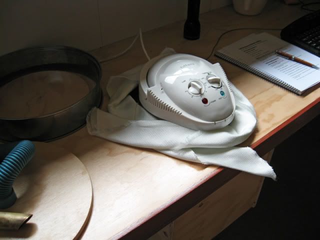

        Hows your gentle breaking in period going Gary?
        Im getting better;
        A couple of quick questions KK (sorry probably asked before somewhere).

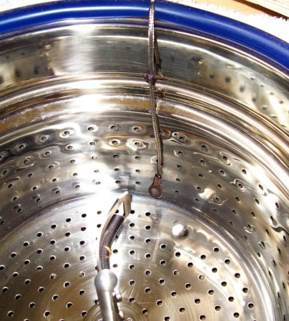

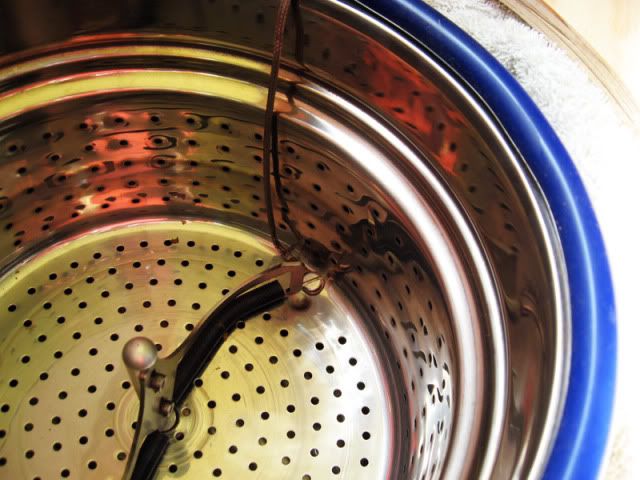

        (a) it appears (not that it really matters) my thermocouple is under reading by about 10 degrees (?) Any idea why?
        (b) She is well and truly insulated - fireblanket + old towel + 12mm ply box (the outside of which doesnt even get warm, so clearly any heat loss is around the top. Has anyone tried another fireblanket rolled into a snake draft excluder shape to drape around the edge of the glass top of the TO? Does that sound like a plan?
        Oh, and ...
        (c) is there a simple way of bypassing the TO thermostat (dont worry I can get a sparky mate to do it!).
          Position the probe end lower - Taking care that its not touching the agitator blade
          You can also place it on the bottom, you just need to press a dimple on the floor of the perforated chamber so the probe sits flat
          Yes I have done it on 1kg + tests
          However you must not block the cooling / smoke escape slits on the TO
          Try an adjustment of the thermostat first (someone has done it)
          Increase its sensor range 15 deg higher & see how that works for you

              • #22
                Re: Another Happy KKTO Owner
                Yeah, Ive just been re-reading Borats thread - all Greek to me but Im sure my sparky mate owes me a favour or two ...
                I think the insulation is a good first step - might be less of an issue when the thermostat cuts the heat off (as it does) and cooling (burping) is an easier option if the heat is there and stays there. That last roast was 650g - could have ramped up a tad quicker (and the 1c to 2c transition got away from me a bit), but it just goes to show what a great system it is ... almost fool proof!! :-[ ;D

                            • #29
                              OK very quickly that w... thing calls  : ;D
                              Insulation a success - clearly speeds up roast and eliminates the saw tooth rate of change seen above.
                              Change of probe position ... fail  ;D
                              Lowers indicated temp another 10 degrees. Mind you it makes sense especially if you bolt it to the bottom (it does look neater) that temp will be of the coldest, furtherest from the heat source thing there (the bottom of the pot, not the beans).
                              However as Flynn says, that just means you change your benchmarks (all the more important with even more insulation muffling sounds until 1C (when I take it away). All in all, not a wasted morning!
