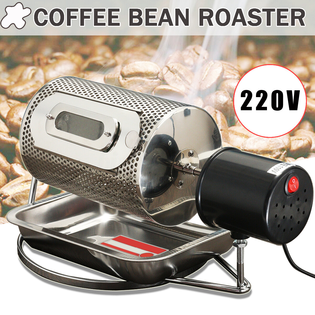

  • DrHenley
    Originally posted by Covalatt View Post
    Hi all
    Looking to get into home roasting, and while trying to decide if I should spend $850 on a Gene roaster, I came across these:
    Has anyone tried these? Do they yield decent results, or should I not bother with these at all?
    Would appreciate any tips.
    Cheers.
    I have the 110v (US) version of the first one, which I use outside. I use a turkey fryer burner for heat and an inverted pot with a slot cut out in the bottom to buffer the heat. The picture below was taken before I added a ThermoPro thermometer, which helped immensely with repeatability.
    So far one pound (~450 g) seems about the right amount. I believe 500 g would work fine too. I did three one pound batches this morning back to back of Kenya Kirinyaga, which has in the past been difficult to get just right. I think I nailed all three batches.
    Much less than a pound and the beans don't have enough thermal mass, much more than a pound and I don't get enough turnover to keep the roast even. I tried a 24 ounce (~680 g) batch of Tarrazu and messed it up pretty badly. It was drinkable but not nearly as good as it should have been. I have had a few outstanding 12 ounce (~340 g) batches. And some not so good.
    When I'm ready to dump, I first cool the beans down in the drum with a powerful blower from the back (so air can go into the drum). When the internal drum temperature gets down below 95F (35C) I dump them into the pan and then put them on a homemade bean cooler to cool the rest of the way.
    If you want to dump hot, you'll need to knock the door off with something like a stick. I did that for a while but found that using the blower to cool them down in the drum (with the drum still turning) worked a lot better and I didn't get burned anymore LOL.
    OH, and that pan that comes with it is WAY too small! A 500 g batch will overflow and spill all over the place. Fortunately I had a much larger pan.
    Click image for larger version  Name:	89qvyR8.png Views:	0 Size:	908.3 ** ID:	839746
