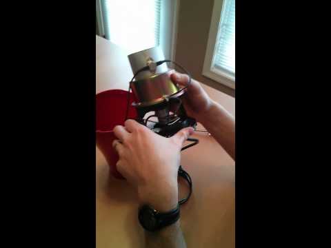

    wirecutter23 thanks for the advice! I will follow it and move the thermostat.
    I suspect the steps are probably very similar to those in this youtube video, which I watched some time ago.
  • wirecutter23
    Also from my experience I reckon it's an absolute must to move the thermostat inside the popper. If you don't, there's a high chance that the popper will cut out due to the high temp during your roast and ruin your batch.
    I think moving the thermostat in the Sunbeam one is pretty straight forward. You just have to remove the case (undo screws on the bottom) and unbolt the thermostat from the side of the popping chamber (you can see where it's attached if you look into the popping chamber - you'll see a dot on the side). Just move it to a place wheer it won't heat up too much and you shouldn't have any problems. No re-wiring needed! Good luck.
