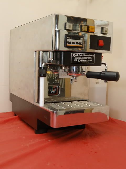

    When I got it the electrics were blown. I have repaired the Gicar replacing various components, fill box now works OK. Disconnected the volumetric dosing and replaced it with a rocker switch, mounted on a plate stuck on with mastic, easy to remove if one wishes a better setup. Old dosing button box is included but I dont know whats wrong with it, the flow unit would need replacing if one was to go back to original.
    Portafilter is from a Rancilio and comes with a single basket only, just add a double basket, PF locks up 4 to 5 oclock needs a better fitting portafilter, cost could be offset by selling Rancilio PF.
    White teflon pannarello is useless, complete new conventional steam arm is $65.00 + GST from distributor or maybe another arm can be adapted whatever arm is fitted, it will need small steam holes as steam is solenoid operated and will need a small tip for control.
    Brew pressure gauge dosent work properly, boiler pressure gauge works but looks to read low, so just adjust temp to taste.

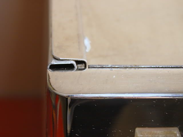

    Left hand side panel has been replaced in the past with a fabricated aluminium panel, doesnt look to bad, depends how fussy you are.
    Rest of machine is chrome showing wear and scuff marks from commercial use, drip tray chrome showing a bit of wear, but overall machine doesnt look to bad.

    HERE SHE IS this is her bad side with the non original side panel.

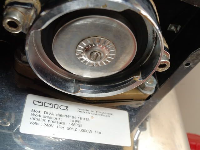

    DIVAS ROSETTE WATER DISTRIBUTION, still not shore about this but thats how its made
    CLOSE UP SHOWING FIT OF FABRICATED PANEL AND TOP, looks better in real life.
